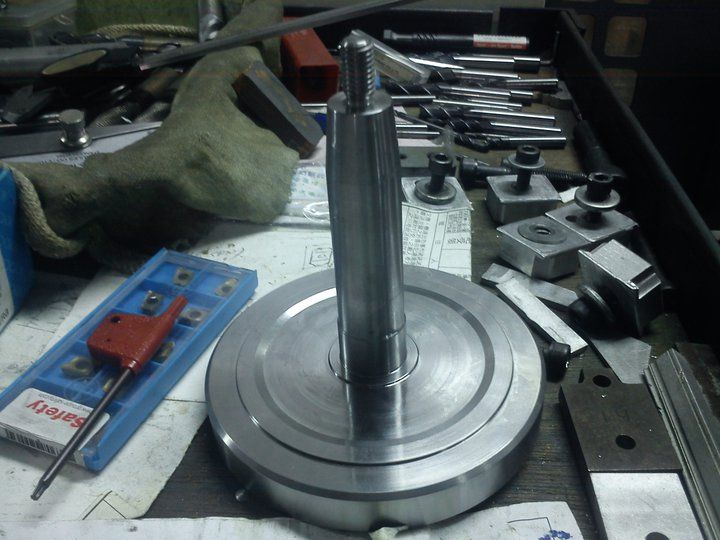

Our race motor was suppose to be ready for testing 2 weeks ago but we were stopped by a certain big Japanese company. This Japanese company have force the local crankshaft facotry from producing our crankshaft.
It is ok, we decided to use CNC machine to creat our own billet crankshaft.
Our CNC billet crankshaft taking form on the CNC machine.
One side ready Smile

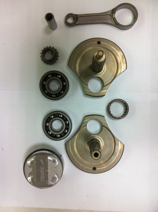

Ready to be assemble after it is been heat treated : )
http://i21.photobucket.com/albums/b296/monkeymagic666/crankshaft2.jpg
http://i21.photobucket.com/albums/b296/monkeymagic666/Crankshaft-1.jpg
